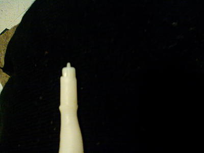

    This pic is a mould i made from the inside of a spark plug lead, the spark plug connection. I'd reefed the inners out after the tow truck dumped me. Anyway the build is that the very tip, that bump, is where the wire from the insulated lead 'sits'. The next bit down is the insulation crimp and then the tube till the last bump on the side. I won't be buying new ones again and adapting a push in connection to secure that wire. $$$ saved. I thought it was held more than that, crimped in it like the other end...how cheap.
