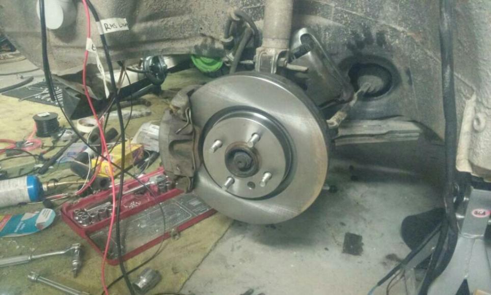

    Callipers and carriers are off a Holden calibra (opel/vauxhall import) v6 or 16v turbo (i cannot remember) and have enough room to accommodate for 288mm discs. Shame vw don't make em that big in a 4 stud.
    Here's a pic of the callipers
    and the necessary shoulder bolts to mount them (the carriers have a 12mm hole but the mk1 hubs require a M10)
    All else that is needed is some G60 corrardo discs.
    George, I'll whip a wheel off for you at the next mk1 meet and you can have a squizz, so you'd better get around to organising one
    EDIT: You'll need to get some mk4 polo break lines to connect everything up correctly. It's fairly self-explanatory

    Jordan that's awesome man, how do they stop? So really its like a vr brake setup size then.

    They pull up fantastically well mate. They are a 54mm piston which is the same as a VR6 caliper, and the pad has excellent disc coverage.
