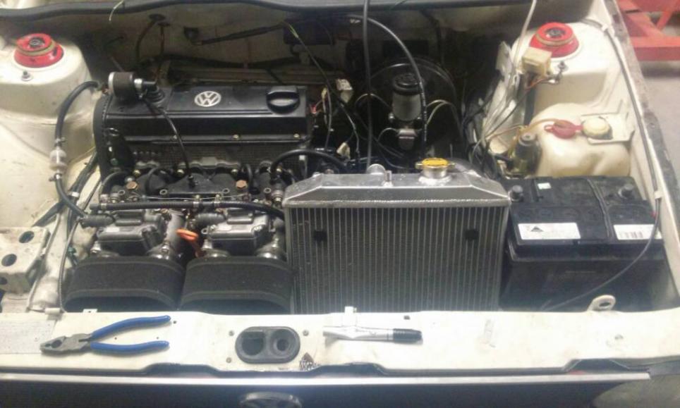

    So the evenings working on the golf are going well, tonight especially so.
    Throttle cable is inLinkage is made from a bicycle brake screw with the wire bent around it on itself. Adjustment comes from a hollow m8 bolt, sourced from a bmx stem I had lying around.
    Positioned the radiator between the carbs and the battery for a mock up. It fits but my god, talk about tight The original plan was to turn this radiator on its side and modify the filler cap so that it remains on the top, however I don't want to modify a part incase I need to replace it in the distant future. Sadly, the only way to get it to fit is to cut the radiator support (out of the question) or tilt it back as it is in the pictures. Unless someone has a better idea????
    Gear linkages connected. 5 speed short shift is mint! Connected the drive shafts also, but needed to rebuild the CVs as they decided to drop all of their bearings all over the garage floor... Anyone know if this is normal when they articulate too much?
    P. S. Mind the clutter and filth in the bay. Just making sure everything fits before I clean her all up nice
