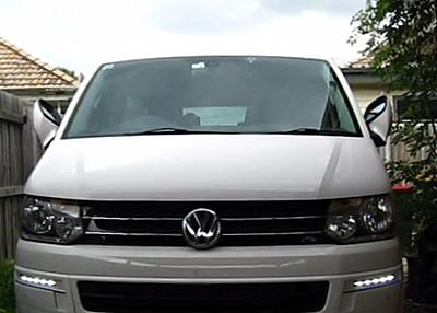

    Hello again, we finally got a few days of good weather so I added the OEM folding mirrors.
    See a video my folding mirrors on youtube.
    T5.2 / T5GP OEM folding mirrors install-mirrors_up-jpg
    The $13 folding control module from eBay works fantastic:
    - Buttons on the door for folding and unfolding
    - Automatic folding on lock
    - Automatic unfolding on unlock (unless they were folded using the button - great design!)
    - Automatic unfolding on ignition (again unless they were folded using the button)
    - When ignition is on, then locking signal is ignored (mirror doesn't fold) - this is great for anti hijack locking
    I added a Jaycar switch to the door panel. It looks OK I think:
    T5.2 / T5GP OEM folding mirrors install-img_0096-001-jpg
    As you can see on the video the mirrors fold into a strange 'upwards' position that barely saves 5cm or so per side. My wife laughed at the ridiculousness of it. Also the glass is more exposed to rain and bird poo from the heavens. Not sure what happens to the rainwater that enters the mirror housing, presumably it frains out through the seams at the bottom.
    Any questions?
