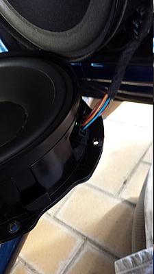

    Bass + Mid Speaker Removal
    Bass + Mid speaker removal is the same as the rear doors, except for un-clipping the wires from the surround and there are 8 rivets vs 4 in the rear doors (twice the fun).
    1. Un-clip the speaker wire that is attached to the side of the surround as pictured below. I bent the inside of the clips a little using this method, but they were fine going back on.
    R36 Dynaudio Retrofit Guide-20140503_143257-jpg
    2. Unplug the bass driver and place the wire out of the way.
    3. Test-fit the Dynaudio speaker plug. If it fits - Plug and Play! (if not, mutter profanities and work out how to solder it on)
    R36 Dynaudio Retrofit Guide-20140503_143129-jpg

    11. Adjust the balance fader all the way into the corner that the speaker has been installed to.
    Attachment 9557
    Testing the driver seat speakers
    11. Slowly increase the volume until you are satisfied that the Dynaudio components are working as expected. I simply put my ear up against each speaker to ensure they worked (at low volume).
    12. Celebrate! The install is (functionally) complete and you can now think about re-coding, door trim labels and subwoofas =)
    - (or facepalm if you don't get good sound - time to pull the trim back off and troubleshoot).
