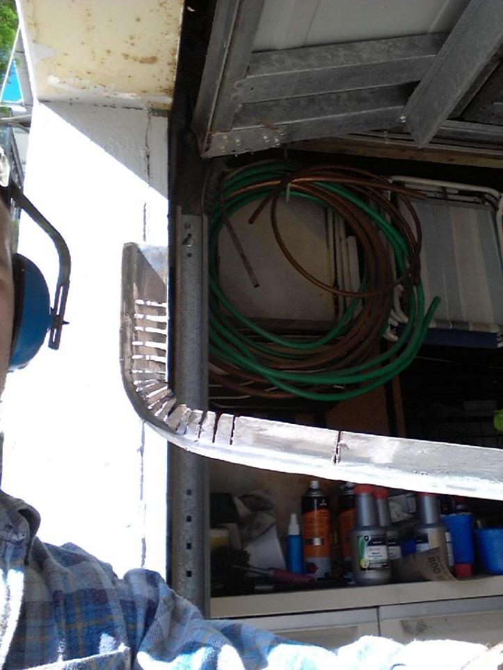

    here's a pic of one of the replacement panels for the flanged section. using pie cuts to get the desired shape, but led to some difficulty welding (especially for an amature such as myself!)
    Here's the cut for the above replacement section
    Here's the finished left side:
    And the (almost) finsihed right side: Nothing that a touch of filler couldn't fix.
