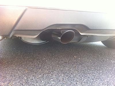

    Yeah ended up heading down to a local exhaust shop to remove the suitcase (80$) as well as the old rear muffler. Replaced it all and it sounds clean compared to the old rattly can noise it made previously.. The entire thing cost me 200 so im happy. Also did a rear wiper and spoiler delete 2 weeks ago which came out sweet,
