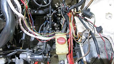

    Losing spark when hot, so time to change the Crank Position Sensor and get a few other issues sorted out.
    Found Oil Cooler hoses from a MK3
    Sorted out the loom pressing onto brake reservoir, the speedo cable was above the loom, swapped it around and pulled the loom into correct position.
    Knock sensors are shagged but temporarily sorted until I get my hands on some. Soldiered on...
    Replaced some old connectors on throttle and CPS, rerouted, rewrapped and reconneced the lighting looms
    Reverse switch is dodgy, will sort that out soon... ran looms in and around P/S pump
    And finally need to resolve the power supply to the CPS, need to find a 5V supply, not 12V. But she's happy for now and will revisit the knock sensors and a few other bits and pieces later.
    Yes, will dump coolant and refresh!
