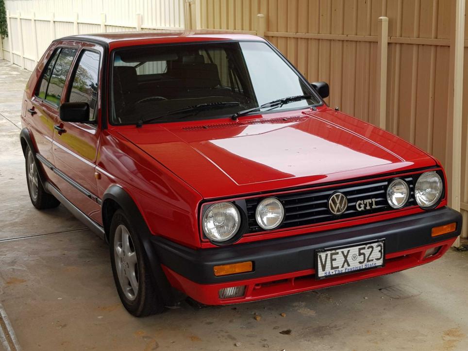

    Gday.... Recently purchased a mint 91 GTI and I'm extremely happy with it other than the automatic transmission. So today I pulled the trigger on a conversion kit from Camden GTI.... probably bit more than I wanted to spend but saves me alot of BS hopefully. No doubt I will be posting and searching the forum for help. Would greatly appreciate tips and advice from ppl in the know. Cheers

    Looks really clean, look forward to seeing how it all goes
    Best of luck,
    Rohan.

    Nice !!!!
    Is it really a red 16v gti ??
  4. Lol nope my name referred to seat cupra I owned previously....I wish tho
