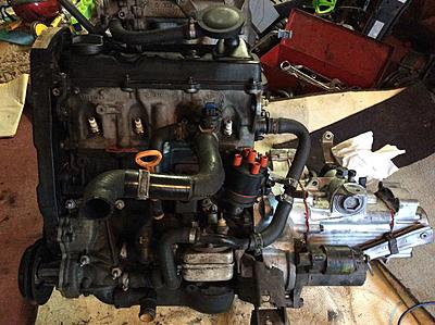

    Conversion almost complete, just got to fix the breather plumbing and chuck it in the car.... Just got to get it through the narrow door way oops!

    Interested to hear how it goes. Is that the 2E I had mate?? if it is its a goodie all the way from Blighty

    Sure is Jmac!

    The engine is now in just have to wait until the weekend to finish the install
    X fingers she produces the nice increase in torque I've read about.
