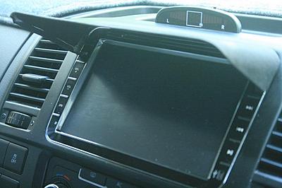

    Found your post and thought I would give you an idea , we bought our latest VW Van and changed the head unit over to a Chinese Android system , its a great unit with loads of features . Reverse camera can be added and also if the vehicle has factory reverse sensors as standard they will show up as well . Now in our case we did not have reverse sensors on the van so I fitted them separately . The unit came with its own display which you can see in the photo above the head unit shade it beeps as you get closer and shows the distance with colour changes . So with the reverse camera and sensors we have got it covered .After-market reverse sensors and camera?-img_74601_zpscd603592-jpg
