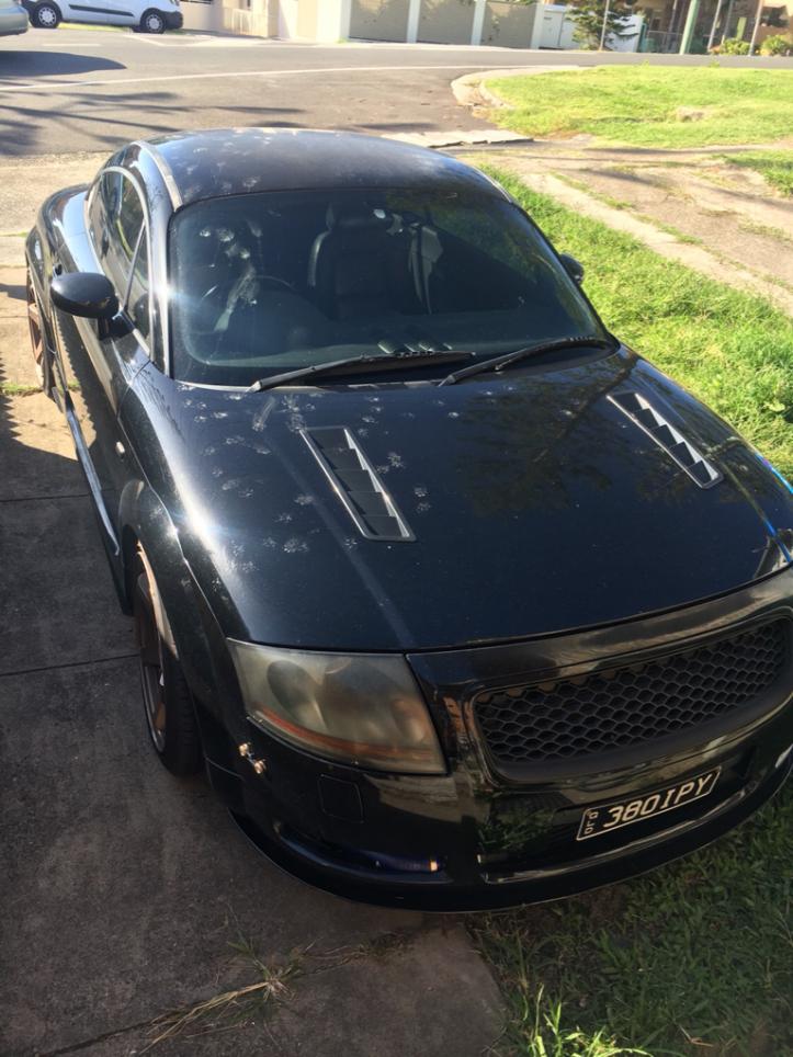

    Also, I cut some speed holes in the bonnet, the cats seem to approve
