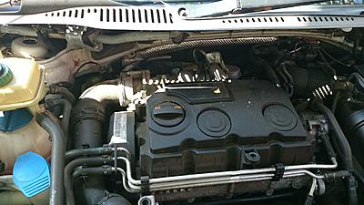

    Today I tried to find out the faulty egt sensor.
    Dashboard warning lights on and Faulty codes-dsc_0031-jpgDashboard warning lights on and Faulty codes-dsc_0059-jpgI guess these are the three egt sensors(brown,black and yellow).
    Dashboard warning lights on and Faulty codes-dsc_0051-jpgI took this photo on the top of dpf forward from driver postion . The middle one is Oxygen sensor. The left one is egt sensor (brown). The right one is not egt sensor. It's pressure sensor.
    The other two egt sensors are going deep inside. I can't locate them.
    Could anyone give me any idea which egt sensor is faulty according to faulty code P0546? how to find out the part number? Thanks.

    Its usually the one with the brown plug that fails......VDUB..

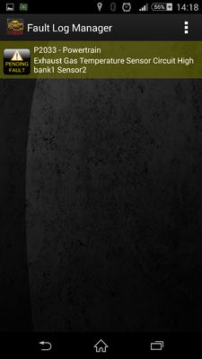

    Thanks for all replies. Checked engine oil level. A littel bit high.
    I unplugged one sensor at a time and scaned faulty codes. Figured out it's the black one.
    Dashboard warning lights on and Faulty codes-screenshot_2014-11-13-14-18-58-jpg the brown sensor
    Dashboard warning lights on and Faulty codes-screenshot_2014-11-13-14-29-28-jpg the yellow sensor
    Dashboard warning lights on and Faulty codes-screenshot_2014-11-13-14-35-26-jpg the black sensor
    When I finished testing and plugged all sensors, something strange happen. All faulty codes were gone.
