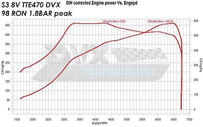

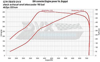

    Tigger do you have a graph of the turbo you got as comparison?
  8. #358
    Quote Originally Posted by INASNT View Post
    All these are for the previous TTE470 with different tuners/cars as the TTE475 which I have has only just been released:
    Tiguan IS38 and Big turbo upgrades-dvx-s3-1-8bar-tte470-98ron_zpsrv3bxe8z-jpg
    Tiguan IS38 and Big turbo upgrades-g7r-dvx-tte470-stock-ex-amp-ic_zpssjavvn2i-jpg

    And now if you only look At the torque of the 10 or so graphs you've sent, the other dyno graph you so called laggy doesn't look "laggy" anymore does it?
    You can make a turbo come on earlier with cam timing and low ignition timing but you sacrifice torque output.
    Another reason why some tuners cannot be fked printing out RPM vs. MAP
  10. #360
    These ones come on 500-1000rpm sooner which I think should be a benefit to daily drive ability.
    Obviously tuning and other hardware make a difference to the response.
