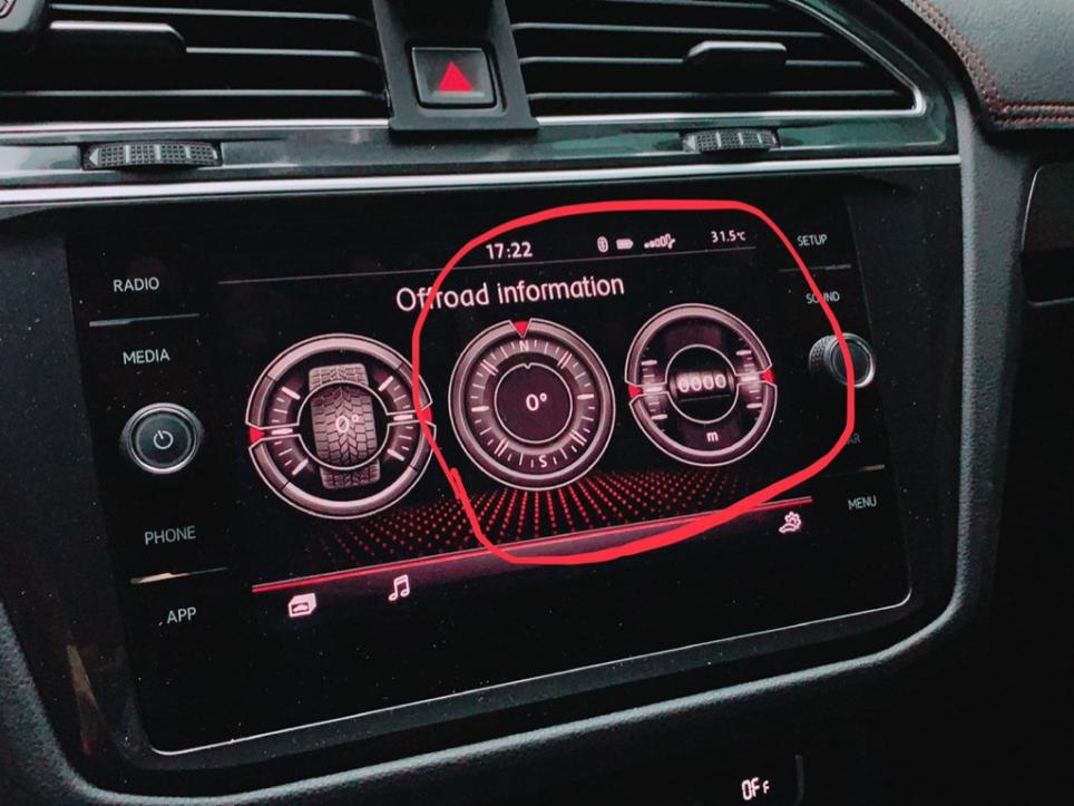

    I actived the offroad information of my tiguan(280 CL /2018 mk2) with obdeleven.But the compass and meter didn't work.Could anyone know how come it is?Please help me to figure it out.Thanks in advance.
    The photo I got yesterday is as below:

    You may have to also activate compass and altimeter (unsure how)
    What country are you in- if an Asian country, some of them don’t utilise compass (maybe altimeter too)
    Does the gps (if an option) show n/s/e/w orientation?

    I live in Taiwan in Asia.
    And the gps doesn't show n/s/e/w orientation.Do you know how to activate compass and altimeter?

    Assuming you have the hardware installed (I’m now doubtful)
    With vcds/obd11, go to module 17(instruments), long coding, byte 10, bit 6- enable(compass).
    Perhaps there’s more to it, but it’s all I’m aware of.

    Thanks for your information.I will try it later.

    Unfortunately,it can't be enable.Anyway,thanks for your help.
