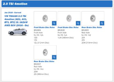

    Bendix online lists both - guess car is compatible with either?
    Brake pads-bendix-jpg

    Quote Originally Posted by Sudoku View Post
    Time to get a ruler or tape measure out and go out to your car
