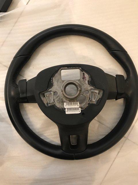

    I've got a wheel from my 09 CC which has the paddle shifters on the back.
    I swapped it out for a Golf R wheel. I can send you some pics if interested

    Here's some pics of the wheel I have, PM
    me if interested. It has the paddle shifters and you could use you existing airbag.

    Thanks for the pictures - I think my existing indicator and swithgear assembly is compatible so wouldn't need that. How much for the steering wheel only noting that the European sites are very competitive for a brand new wheel.

    No worries you should be able to use your existing indicator assembly and airbag off that model, the indicator assembly is only needed if upgrading from mk5 based car's.
    I'd do the wheel alone for $300
