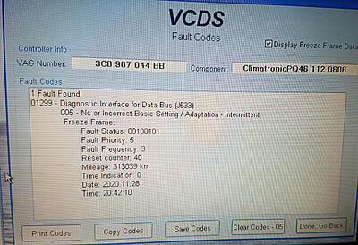

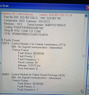

    So, I think I got the new, upgraded can gateway installed. With new gateway in situ I chose 19 Gateway and the Installation List. I've had the Installation List saved from the old gateway so I knew which modules had to be installed. Eventually, I managed to have the coding accepted. However, now I'm getting some unexpected extra errors.
    Upgrading and re-cording CANBUS gateway-19-can-gateway-jpg
    This one is complaining about Central Convenience and Digital Sound package?
    Upgrading and re-cording CANBUS gateway-climatronics-01299-jpg
    This one about Climatronics.

    Clear faults.
    If the fault isn't listed as 'static' then it may be from something being unplugged etc (intermittent).
    If the faults return after clearing and cycling ignition then look at them.
    The no coding information error means that it can't match the module against the database (ASAM) to identify what it is and what the configuration parameters are.
    Shouldn't happen with genuine VCDS. Happens all the time with poor clones.
    Reboot laptop and try again.
