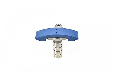

    I have a 1.8T ( 20 v. ) engine with VVT
    ECM: BOSCH Motronic ME7.5
    I randomly keep getting the below fault code on the VVT-system when I check with VCDS.
    16395 - Bank 1: Camshaft A ( Intake )
    P0011 - 002 - Retard Setpoint not Reached ( Over-Advanced )
    I don't have any mechanical noise or slamming/rattling from the head/chain.
    I have opened the valve cover to check the chain and everything looks like new on the plastic chain sliders
    and I have no oil deposits ( changes oil regularly ).
    1. What does this error code mean so that one understands the meaning of it ?
    2. Can someone explain in detail how the VVT system works on the 1.8T ( 20v. ) engines ( 2001-2010 ) ?
    3. What happens if the VVT is closed all the time and does not regulate ?
    4. What happens if the VVT is open all the time and does not regulate ?
    My engine generally feels weak in the midrange and has relatively high fuel consumption.1.8T 20V non VVT head to VVT conversion-camshaft-adjuster-repair-audi-18t-jpg1.8T 20V non VVT head to VVT conversion-motor-koder-jpg1.8T 20V non VVT head to VVT conversion-fdghjkk-jpg1.8T 20V non VVT head to VVT conversion-camshaft-adjuster-rebfreudi-18t-jpg

    Make sure you have good oil pressure. Remove the sump and check the pick up is clean. Also take the solenoid off the tensioner, and make sure the plunger is free to move where the spring is in your photo. I had one once where there was some debris jamming it up.
