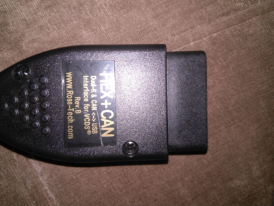

    Quote Originally Posted by gaucho View Post
    Here even with no warnings it goes back to Status, is there any vcds config to change that? Doors open I can see in the driver's panel, no need to see it in the central panel screen.
    Anyone?
    Also, I have this cable from like 3 years ago... is it compatible with golf MK7? is it ross tech original?
    VCDS (VAG-COM) codes and programmable options for Golf Mk7-caborosstech-png
  3. #1183
    1,840
    Anyone?
    Simple way to find-out if it's genuine - simply download the latest RT software and connect the cable to the laptop. If it's genuine, the firmware in the dongle will need to be updated to be compatible with the latest software and everything should be OK. But you should be aware that RT no longer sells these cables (they are based on a design that's over 20 years old - apparently).
    Of course it the cable in the picture is a fake - then I would suggest that you chuck-it in the bin because it's rubbish and that's where it rightly belongs (and because after linking it with the latest RT software- it will no longer be usable)!
    the cable was missing. I've finally found it in an old drawer... what do you mean is that if I run the updater program it will disable the cable if it's not ross?
    also, do you know how to change the main page in the CAR menu item to always start in Fuel Economy page, not status? I don't use the status page..
    Gaucho: I think that I have found your cable:
    original picture jyoung8607
    And guess what? You have participated-in and supported the despicable market for IP theft because:
    original picture Benevolent Dictator
    My suggestion is not to update the software, but instead - immediately connect the cable to your car and poll the MIB controller @ address hex5F - then make a booking with your dealer (you will need it!)
