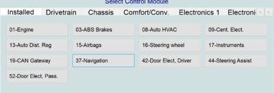

    How and where to register mine Alpine X901D-G7 navigator ?
    Hello.
    I have change in my car the Radio Composite Colour (which was without navigator) with the Apline X901D-G7 navigator.
    Alpine has full CANBUS ability and works very fine with the steering controls and the MFD. I Think some Car setup menus are missing.
    Where / how to tell to the canbus(?) there is a alpine navigator installed?
    If i go to 37 Navigation, i got a error(maybe because there was only a radio before installed and no navigator)
    Point 37- Navigation, does not appears automatically (only if i select this, in the Gateway List)
    VCDS (VAG-COM) codes and programmable options for Golf Mk7-snap5-jpg
    VCDS (VAG-COM) codes and programmable options for Golf Mk7-snap6-jpg
    VCDS (VAG-COM) codes and programmable options for Golf Mk7-snap4-jpg

    ^^^^ marsias: not sure what's happening with your car - your first picture doesn't show that the MIB is registered in the CAN Gateway module - you don't mention what type of vehicle this is - the second picture suggests that you either have a pirated cable, or if it's genuine, its out of date - and in any event, SATNAV facilities on OEM MIB units for MQB platform vehicles don't usually have a separately registered control module @ address hex37.
    So -it's all a tad strange! Perhaps you should post-up a COMPLETE (meaning totally unedited) copy of an auto-scan for the vehicle. AND also some information about the car itself.

    After market units don't need to be registered in canbus gateway installation list.
    They just respond to can messages on the bus.
