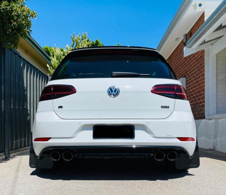

    New additions.
    Rally Armor mud guards.
    Ferodo DS2500 brake pads.
    Rally Armor mud guards thoughts. Super good quality and actually do a bloody good job of keeping crap off the car. Need to play with them a little more to straighten up the rears. I’m unsure if I’ll keep them on full time as the look of them has me a little confused. Not sure if I really like the look. Side on and from the front looks good. From the rear they look a little odd.
    Ferodo DS2500 brake pads. Upgraded the original performance pack pads as I absolutely cooked them on a track day. Did a 2.14 around The Bend international circuit which I thought was pretty decent. I was keeping up with and pulling away from a few C63 Mercs and was hitting 230km/h on the straight. Destroyed many cars worth much more money than the little golf. Even had one of the C63 owners come up to me asking what I’d done to it as he couldn’t catch me on the straight. Was a hoot. Anyhow back to the brakes. They performed alright for 3 sessions then they were done. After I’d got home and then drove the vehicle again I had a lot of vibration in the brakes. I thought I’d warped the rotors. Drove it for a couple of days and then did a few heavy braking runs. Turned out they’d left a heap of crap on the disks that needed to get burnt off. Replaced the pads and bedded the new Ferodo’s in. Haven’t tracked it again and likely won’t but on the test braking runs the improvement is significant. These pads have a significantly bigger pad surface area when held next to the stock also appear to be much thicker. They seem very well suited to everyday use but can apparently take a beating. Time will tell. They weren’t cheap so here’s hoping they last longer than the stocks.
