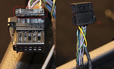

    My questions above beautifully illustrated:
    Golf mk7: Auto Start/Stop disable switch - who wants to help?-where-flap-jpg
    Golf mk7: Auto Start/Stop disable switch - who wants to help?-does-come-off-jpg
    Golf mk7: Auto Start/Stop disable switch - who wants to help?-gap-much-bigger-jpg
    Golf mk7: Auto Start/Stop disable switch - who wants to help?-where-groove-jpg
    Golf mk7: Auto Start/Stop disable switch - who wants to help?-where-cover-jpg

    Hopefully this picture might make sense.
    It's clipped around the side edge halfway along.
    I unclipped it fairly easily with a thin small screw driver in the gap where the pink line is.
    It then folds back towards the wires - see arrows.
    That's why it looks odd in the first picture I have.
    This flap stops the wires coming out because the crimp gets blocked by the flap edge.
    Once the flap is out the way you push the spring bit shown in the first picture while pulling out the wire at the same time.
    You shouldn't need much force.
    I'll have a look tonight at my pictures if there was a better view or part number.

    Ahhhhhhh that seems much clearer now. The first photo of yours made it look like there was some block there! Funny how camera angles can paint a totally different picture.
    I'll give that a try after work and see if I can get to those pesky pins. I have to say I spent a long time look for the clip and could not see it. Did you fluke it, or did you know what you were looking for? I'm guessing the latter lol. I'll try and take photos when I do the install.

    Yes the camera angle does look odd even though I know how the connector comes apart.
    I've pulled a few connectors apart in my time and I could just see the "Hook bits" on the edge so had a go un-clipping the flap.
    It came off pretty easily.
    It's pretty rare that you can't get pins out of most multipin connectors somehow.
