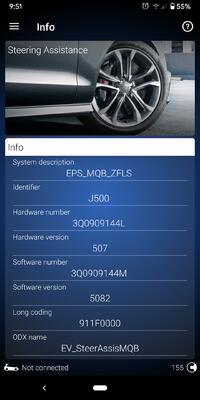

    Hi! I have exactly the same problem. Could you please check software version that are now installed in you Power Steering Assist module?
    Or pls attach screenshot with full info about your updated module. Thanks a lot!

    Not sure if these are screen shots you're after? Both are using the OBD11 app, in the Control Unit menu, selecting Steering Sssistance 44. The first picture is the info screen and the second picture is the history screen.
