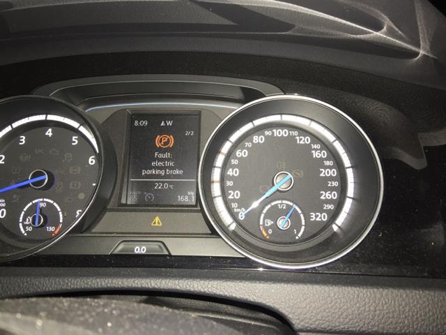

    Jan 2015
    21
    Electronic park brake / hold failure
    Anybody had issues with the electric park brake?
    I was driving along when my auto hold failed and I got this error. When I stopped the brake didn't auto engage when I stopped and then the message disappeared. Since then the brake no longer auto engages or auto holds. When I pull on the brake it appears to engage, but I am leaving it in gear just in case. Not happy.
