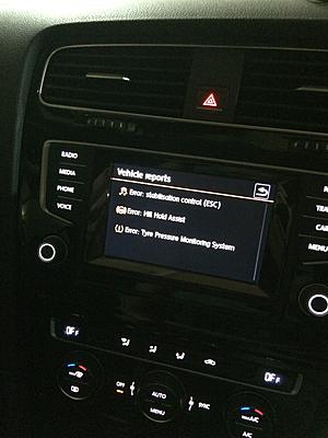

    Looks like I'm the first member in the MK7 sub forum to have experienced this issue. Did a quick google search, issue appear to be affecting quite a few users from around the world in other forums. Wondering if anyone has experienced this before or aware of a solution.
    Was pulling into the carpark at work today, low speed, full steering lock to the left when a list of errors appeared one ofter the other on the MFD:
    ACC
    ESC
    Hill Hold Assist
    TPMS
    The vehicle status screen in the MIB also lists the same errors + a few more once the engine starts.
    Battery SOC was at 80%
    Turning the car off and back on did not resolve the issue however, driving the car for a few hundred meters did clear all the errors.
    I've emailed my sales manager to see if they have a fix for this.
    Car is MY15 103TSI with 2k on the clock.

    I had a similar issue with a few different electronic systems (notably the ESC), and like you once I drove a few hundred metres or so the errors disappeared. Although this was on a MK6 Golf these issues and circumstances sound similar.
    In the end after being error free for 2 weeks after the first symptoms occurred, I had the car parked outside on a very cold 5°C night (cold weather discharges your battery faster) and when I went to start the car the battery was dead/couldn't muster enough energy to turn the starter motor, although I never had a battery warning issue and the other electronics like headlights (bi-xenons) and media unit worked perfectly fine. The car was almost exactly 3 years old (which is a typical battery lifecycle).
    So in summary, I have a feeling your battery is struggling/dying. The voltage probably dropped below a threshold for those functions to run (hence the errors). The errors would then disappear because the alternator would be feeding a healthy voltage back into the battery which might perk it up temporarily. I would recommend asking for a battery replacement, and then a check to see if you have any electronics leaking energy (which could could prematurely deteriorate your battery or leave it in bad health).
    On a sidenote, if people want signs to look out for a dying battery look for:
    1. Engine taking longer to start up.
    2. Slowing electric windows (Particularly noticeable when engine is not running, that being said they will always be slower when engine is not running, but they will be really slow if the battery is dying).
    3. Vehicle electronics errors which disappear when on the move.
    I could be wrong, but make sure you keep us updated!

    Thanks RMBB for that, I'll keep an eye on the battery charge, but my Stop / Start system has been working correctly the whole 40 minutes drive to work, I would assume if the battery is running low on charge, Stop / Start wouldn't stop the engine?
    Also DV52, just got home, ran Auto-Scan on VCDS, have a whole range of errors that have since been cleared. Not very familiar with fault code reading, but it would appear the fault originated from the ABS controller?

    agentthumb: I'm not discounting OP's suggestion regarding the battery, but I would have expected messages like: Power Supply (B+) Terminal 15 - Low Voltage, or Power Supply (B+) Terminal 30 - Low Voltage, or Supply Voltage (B+) in the autoscan report.
    The fact that you have a string of Fault frequency:1 and Fault frequency:2 in a number of DTCs confirms the intermittent nature of the problem (not good for fault finding). I guess it's just a matter of keeping a close watch on the control modules in your list

    Be aware that when I ran through my fault codes at the time, no errors/malfunctions recorded whatsoever relating to the battery. I can't be sure about why I wasn't given a warning, but one theory may be the battery was malfunctioning. I also had the errors looked at by a VW specialist and they could not even tell me what was wrong.
    To answer your Stop-Start question, once the car has travelled about 200m the alternator will power the battery back up and for Stop-Start purposes the battery will hold up just fine.
    So from what you've said I would not be ruling out the battery just yet!
    I don't have a copy of my fault codes to compare against yours, although where our systems had the same function/features like the Steering assist, Airbags, ABS and engine they threw up the same error codes.
    If it is the battery causing this issue, which to me looks very likely; just know that once you are moving the systems will all work just fine and you shouldn't worry for your safety regarding the airbags, steering assist, engine and ABS.
    Hope this helps! Keep us posted.

    So took the car in, they ran a scan and couldn't find anything wrong, as expected. Cleared fault code.
    Hasn't happened again since tho, so not too worried. At least I have it on record now if there's ever a dispute later on down the track.
