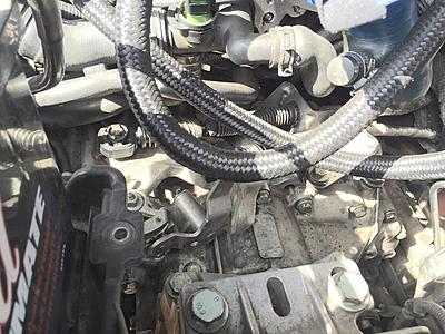

    stock shifter throw compared to dieselgeek sigma 6 throw. reduced? yup! notchy? nope! easy to get into all gears? yup!
