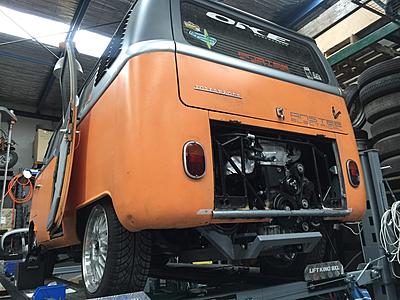

    Hi all,
    Still progressing with SplitR32 bus to be ready for Vits in Albury this year and was wondering if someone could help with some advice.
    I require the 2 pin coolant temp sensor normally installed near radiator and also a housing for it BUT different
    to the factory setup.
    The housing needs to be a "T" style with provision for the sensor and connections on each end for 32mm rubber
    radiator hose..( Not the quick connect style ) Which housing to use is the problem.
    Can anyone help ..?

    Try N 906 931 01 32mm T piece with provision for temp sender. Used on some 2L TDI s. Pete

    Thanks Pete,
    That looks perfect..
    Just made my day getting that info so quick..
    Cheers Tony
