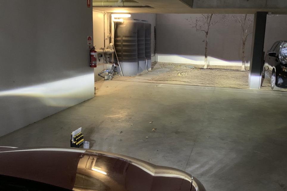

    Mid change over to these...
    VW Golf Mk5 Projector Headlights 2005-2008 (fits halogen headlight models) - Supernova Lighting
    I think the authentic projectors require some wiring modification - not 100% sure.
