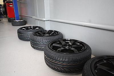

    Looking through a lot of sites and build threads i saw a lot of VW car owners go for BBS wheels and i guess i feel there not really my style so i decided to order some Rota Grid for the front and Grid R's for the rear
    The grid's of the front are 18x8.5 ET44 and the Grid R's on the rear are 18x9.5 and i carnt remember the ET on them at the moment, will up date. As for the tread as i was running a little short on cash at the time we went for Achilles ATR sports front and rear, I'll update later with sizing.
