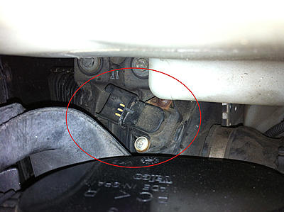

    Hi All!
    I'm really hoping someone can shed light on this 'issue' I found..
    Basically, I have MK4 Golf GTI, with 1.8T AGU engine. I have an APR Stage 1 map, but the rest of the engine is stock.
    I was looking in my engine bay, on the drivers side, down between the window washer bottle and the back of the drivers side headlight, to where I can see the top of the ****ty SMIC... and what I noticed is what appears to be the MAP sensor plug, but with nothing plugged into it... and for the life of me, I can't see any spare wiring that isn't plugged in to anything ...?!?!?!
    I do not have my VCDS set up at the moment (I had to reformat my mac), so cannot check for errors, but I had previously been checking every couple of months after the 1.8T engine conversion, with no error codes (except for the drivers side heated mirror which isn't heated).
    Can anyone shed any light on this? If it's been like this since the engine install, why there were no engine fault codes? Could this be why I seem to get 'heat soak' issues easily on a warm day? (although I do live in the middle of Sydney, with lots of traffic and only have a SMIC)
    Many thanks in advance for any help!
    MAP sensor not plugged in to anything?!?! MK4 GTI, 1.8T, SMIC,-img_4951-ed-jpg
    MAP sensor not plugged in to anything?!?! MK4 GTI, 1.8T, SMIC,-img_4954-ed-jpg

    It doesn't do anything on an AGU. I reckon as Australia got sent all the leftover AGU engines in mk4 GTIs after they stopped selling them in Europe. They ran out of SMICs without the hole, so had to fit MAP sensors to plug them.

    haha, well, I definitely hope it's that simple..
    So, if I were looking at a better FMIC, I could look at ones without a MAP sensor in the piping?

    MAP <> MAF
    MAF - Measures the mass of the air flowing into the engine. Located just after the air filter.
    MAP - Manifold Absolute Pressure, measures the pressure in the system.
    So techinlally only one or the other would really be needed. But AGU does not use the MAP on the IC.
    If you have a look around you may also see a plug behind the driver side headlight that does exactly nothing also. I wonder if these 2 go together ?

    MAF is mass air flow, the plug immediately after the air filter, it in fact connects to its housing - car wont run well without that plugged in

    No no. The engine managment is programmed to use the MAF. They could have designed it to use the MAP instead, with no MAF at all.
    For the AGU VW probably choose MAF as it provides a more accurate reading, and therefore use less fuel. Some engines use both.
