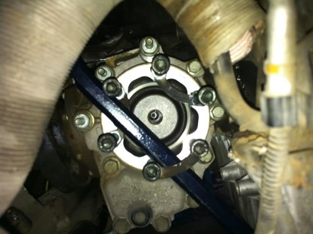

    Well i got down and dirty a couple nights ago with the bora and off came the gearbox!
    Followed this guide VWVortex.com - Transmission Removal Clutch Replacement diy Quick Version and its pretty much spot on. Note that when seperating the transfer case and gearbox you can expect a flood of transmission oil to spill out. I'd recommend draining the box before doing this to save getting covered in oil... doesnt taste great
    Two of the trickiest bits was manouvering the gearbox off after unbolting it and also getting the 6mm allen bolt from out of the transfer case, although not hugely tricky just frustrating (the one buried deep in the drivers side driveshaft, step 21 in the vortex guide) Initially i bought several allen key extension shafts however i broke all 4 that i bought!!! In the end i ended up making my own by welding a 6mm hex head with a drive adapter to the threaded rod from a spring compressor... Believe me, this one will NEVER break!

    Pics:
    The damnn 6mm hex buried in one of the shafts
