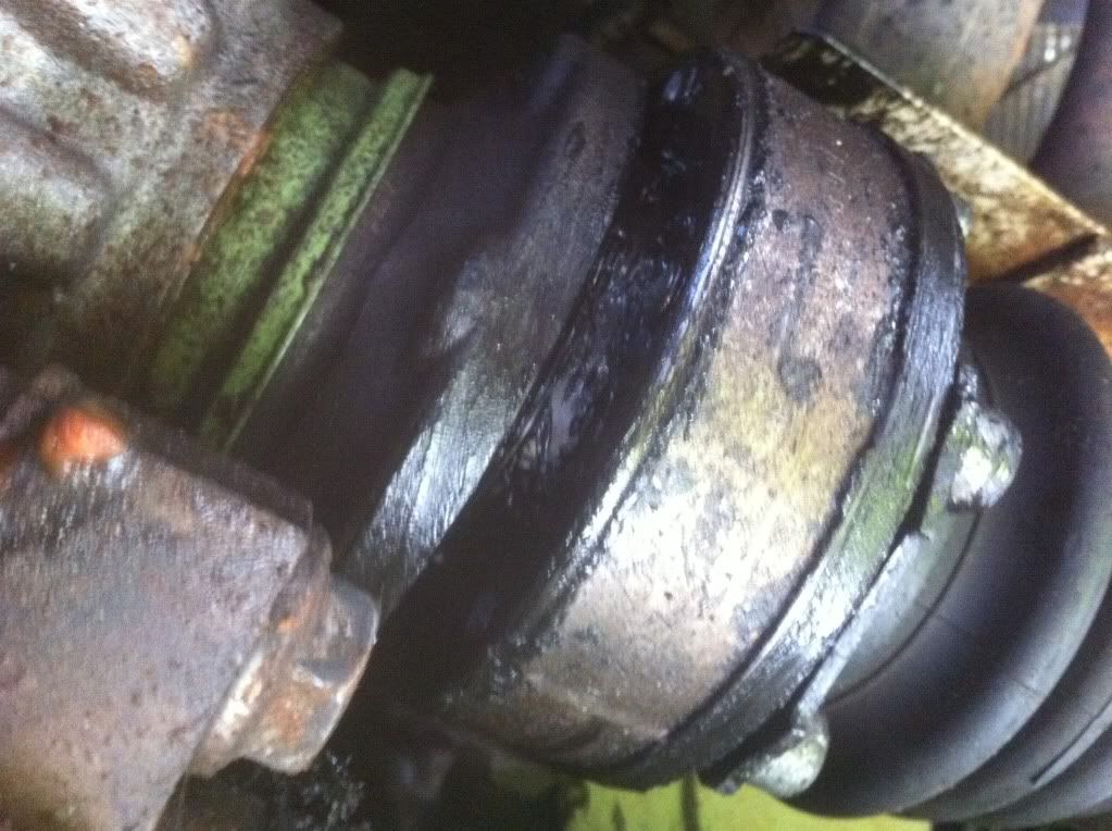

    anyways a mate came out with a trailer and got my car and took it home for me and today i climb under to find it actually snapped all the bolts that hold one end of the driveshaft to the gear box :S meaning the left over of the thread is stuck in the gear box i dont know much about these sorta things but would i have done the CV joint as well ? i wanna work out as much as i can before going and giving it too a mechanic and being ripped. it would be even better if i could just get parts and do it myself..

    a picture i took under my car today to give some sort of idea.. you can grab the drive shaft there and wobble it around as in not attached at all.

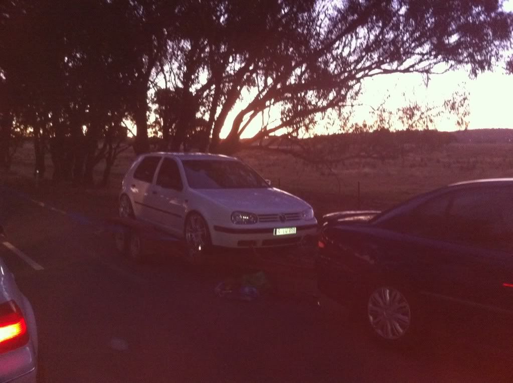

    getting towed away
    also i cant see how it would but would the fact my driveshaft and sway bar like to hit each everyday have anything to do with the lead up to this happening??

    That sux mate. At bunnings they have this tool that will extract snapped bolts. You drill a hole in the centre of the snapped bolt screw this part in and then you can undo the broken bit out. Good luck with your car dude.

    cheers will go have a look today if i can get the broken bits out i should be able buy a new driver side driveshaft/cv and chuck her in and hopefully have no dramas.
