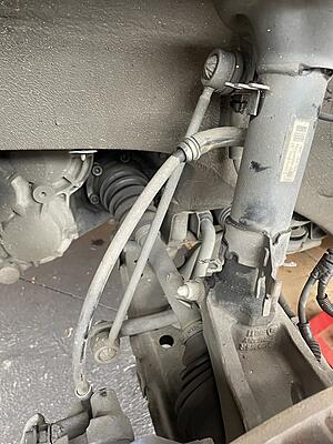

    Fronts had to be done in 2 stages. Struts and springs, then the R32 knuckle swap.
    Undo top mount nut - 60nM
    Bora R32 Build Thread-img_5916-jpg
    remove sway bar link - 90nM, brake lines and abs wiring from the strut.
    Bora R32 Build Thread-img_5918-jpg

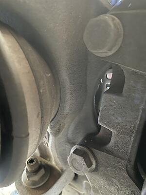

    Removing the control arm was fairly straight forward, 18mm bolt / nut at the rear (70nM +90')
    and 1 at the front (also 70nM + 90').

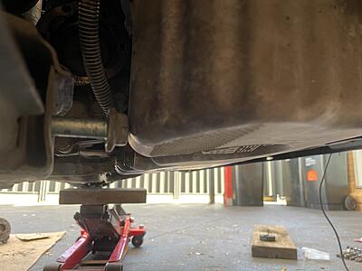

    Problem with the front one was it kept hitting the sump before I could fully extract it.
    Bora R32 Build Thread-img_6174-jpg
    So I was forced to lower the whole subframe to get the clearance needed and pull the arms out.
    Bora R32 Build Thread-img_6175-jpg

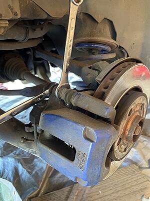

    starting at the rear, lever down the handbrake cable bracket and push the cable end out.
    Bora R32 Build Thread-img_6429-jpg
    disconnect and cap the line and plug the caliper.
    Bora R32 Build Thread-img_6434-jpg
    undo the slide pins (install back to 38nM)
    Bora R32 Build Thread-img_6436-jpg
    undo the carrier bolts. (install back to 80nM)
    Bora R32 Build Thread-img_6427-jpg
    And it's off.
    Bora R32 Build Thread-img_6435-jpg

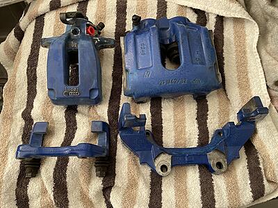

    next up was the most time consuming sh*t of the whole process.
    Stripping down, cleaning and masking them up.
    Started by splitting the front caliper and carrier.
    remove the protective cap
    Bora R32 Build Thread-img_6440-jpg
    then slide pin (install back to 25nM)
    Bora R32 Build Thread-img_6441-jpg
    push the pistons back.
    Bora R32 Build Thread-img_6443-jpg
    * Rear pistons are twist and push, may need a rewind tool for that job *
    Hit everything with a degreaser, then a hose down, then hot water and dishwashing liquid with a scrubbing brush.
    After that, dremel with a wire wheels, wire brushes, sand paper. Basically whatever it takes to get those b*tches clean, even if it means you remove a little paint. THEN another quick wash
    Bora R32 Build Thread-img_6448-jpg

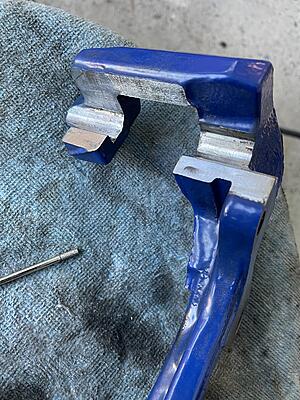

    On the rear, you can pull off the slide pin bushes. On the front I found it easier to push them from the side that faces the pad. Little bit of WD40 helped
    Bora R32 Build Thread-img_6450-jpg
    Also decided to sand down any rust spot where bare metal was exposed. For example where the pads ride.
    Before
    Bora R32 Build Thread-img_6444-jpg
    After
    Bora R32 Build Thread-img_6445-jpg
    Then time to mask up.
    Bora R32 Build Thread-img_6451-jpg
