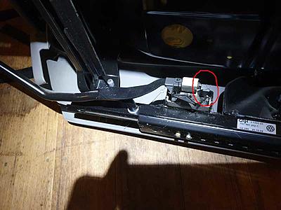

    This is a stock standard 2010 sliding seat. This part is on either end of the adjustment lever for sliding the seat. Acts as a restrainer/stopper when not broken.
    Noticed that when sliding the seat back, this part was fouling on the battery under the seat. When I took the seat off I could see one of these parts was broken. I then managed to break the other one too
    I was going to see what I could find on ebay maybe.
    Part number might be 7HO.881.181a or 7H0.881.181a
    It might help if I knew what it was called?
    But my workshop manual doesn't go into that detail.
    Looks like I'll have to see what VW will want to charge for these.
    What's this black plastic part called? T5 front sliding seat adjustment stopper?-front-sliding-seat-broken-black-plastic-2b-jpg
    What's this black plastic part called? T5 front sliding seat adjustment stopper?-broken-black-plastic-2-jpg

    I suppose thinking about it a bit more, I could just use some fine tie wire to repair it?

    Have been to VW spares. It's called a - Cap, Release Lever TR 04
    My broken part - 7H0.881.181a
    Was superceded in 2005 as an individual part...my vehicle is 2010...it was priced at $4.50 each
    The new part is VW7H0881181...has to come from Germany around 4 to 6 weeks...cost is $29.70 each

    $20 on ebay from the UK incl post Genuine Cap 7H0881181 | eBay Goes to show how these car companies make so much money from their customers .
