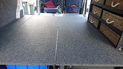

    Can still slide 2.4m x 1.2m sheets in on top of the drawers:
    Jonno's Build-dsc_5245-jpg

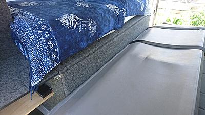

    Bed
    Jonno's Build-dsc_5234-jpg
    Or in single mode (more to come on this):
    Jonno's Build-dsc_5235-jpg

    How the bed gets set up. This pic actually shows the frame setup I made for when the seat isn't in. As we haven't taken the seat out yet we just set it up in rapid mode by swinging out the 3 inbuilt rails on top and propping the seat up to the right height.
    Jonno's Build-dsc_5233-jpg
    Jonno's Build-dsc_5239-jpg
    Jonno's Build-dsc_5238-jpg

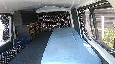

    Our small lounge room, comfortable for 3:
    Jonno's Build-dsc_5231-jpg

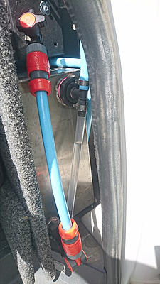

    I originally had a pump which went to an outlet at the back but the noise drove my bananas and I couldn't find a quiet pump. I set this up temporary for our Fraser trip but we loved the silence and simplicity of gravity feed so much we are keeping it. This has breathers, overflow, indicator, outlet and filler:
    Jonno's Build-dsc_5240-jpg
