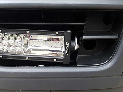

    Just wanted to update about my led lightbar experience. Was also hoping for an answer to a question.
    I initially followed Sunny43.5's as usual generous quality advice and paid to get fitted the same type of 20" bar in the same way.
    Vw t5 brighter headlight options!!
    Installing a light bar or driving lights-light-bar-01-jpg
    The ebay one I got always seemed to spray light everywhere but where I wanted it. But I found I almost never used it so that didn't really matter.
    The problem was in the fitting. The plastic grill section of the bumper was not trimmed back enough and was rubbing in at least 2 positions. I didn't notice this until un-repairable cracks started appearing in the plastic grill and they just kept growing. It looked terrible.
    So I followed the similarly excellent advice from Markee and purchased the same 32" bar and made up the same brackets.
    And so it starts.....my new T5 LWB Motion
    Installing a light bar or driving lights-light-bar-04-jpg
    (while my pic makes it look not straight....it is actually remarkedly so...considering my usual standard of workmanship
    I was hoping the larger light bar would allow me cut away all the broken plastic and disguise what had happened.
    (you can't buy the plastic grill section separately - you have to buy the complete front bumper)
    The plan has all worked extremely well except under the light there is now a large gap.
    Would anyone have any suggestions about how to cover that gap without making it look worse than it already does?
    Thankyou.
    Installing a light bar or driving lights-light-bar-02-jpg
    Installing a light bar or driving lights-light-bar-03-jpg
