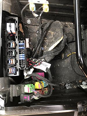

    2010 Multivan Convenience Module-vwdrivers-jpg
    Drivers Seat, Towing Module on right

    In your first photo there are several connectors unplug them and check carefully for corrosion , our central locking was playing up on both of our 2 T5's when I unplugged the conector it had more greenery than an outback farm on those contacts . You can buy a contact cleaner and then a second product to improve the transfer of power through the pins . Easy way to check which one is the culprit is to discconect one at a time and see if the locks stop all together . Also check the remaing ones under the other seat as well , seems the T5's have an issue with moisture under the front seats .
