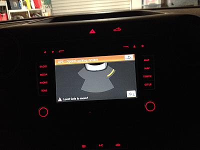

    Wasted no time when I got home and installed the RNS510
    Sharkie's TSI Amarok Build-rcd310-jpgSharkie's TSI Amarok Build-dash-jpgSharkie's TSI Amarok Build-rns510-installed-jpg
    Quick code with VCDS and test to pickup the satelites and done.
    OPS Rear sensors working perfectly too!
    Sharkie's TSI Amarok Build-rns510-ops-jpg
