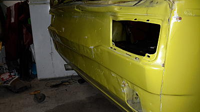

    So I guess that I should give you guys an update seeing as a bit has gone on lately!
    Patience isn't on of my virtues, so whilst waiting, for my mate to give me time on his Autorobot, I decided to pull out the worst of the damage with what I had available.
    .Saving the Swallowtail-20170301_190904-jpg
    So I tied it to a bobcat and drove!!!.......Not quite but close.
    Actually there was a fair bit more involved. To get the damage out needed pushing for inside, as well as the pulling from outside.
    Saving the Swallowtail-20170301_190933-jpg
    I don't know why, but I don't have a picture of the first stage pushing out the bulk of the damage, this one was pushing the left side where even though the hit was on the right, the force had pushed everything to the left.
    after some dressing up the SWALLOWTAIL WILL be saved
    this is after pushing it out and pulling the support panel out with the bobcat.
    Saving the Swallowtail-20170301_193609-jpg
    then after dressing everything up a bit
    .Saving the Swallowtail-20170305_200043-jpg
    Yeah it ain't pretty yet but with a shrinking disc and a S**T load of work it will be like new!...NO BOG
    I can't go any further now until I can pull the quarters out(they need a slow pull from the outside that I cant do)
    To correct this!
    Saving the Swallowtail-20170305_200153-jpg
    and this
    Saving the Swallowtail-20170305_200142-jpg
    Once the inner panels and quarters are straight, I can replace the top panel with one of the 4 that I just bought, well 5 actually, but 1 is a new project!
    Saturday looks to be the day, but I'm not holding my breath! John my mate had about 30 hail damage quotes to do between Tuesday when I last saw him and Friday arvo, if we're going to do the golf on Saturday morning..... fingers crossed!!!!
