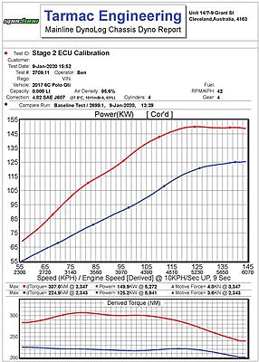

    Hey mate - the 2016 model will be 1.8T Polo correct? See screenshots below showing the difference you can expect between stock and stage 1. https://www.facebook.com/TarmacEngineering/
    What these Polo's really need to help reduce the wheel spin is a dog bone mount insert which stops the engine moving as much under load and therefore helps reduce wheelspin. Good cheap mod. HP Dog Bone Engine Mount Insert - Race - VW Polo 9N/6R, Skoda Fabia/Roomster - Harding Performance
    Dont forget that your Mk4 Golf GTI would have been a 5 speed, and the Polo GTI is a 6 speed so the gears are a bit shorter hence why you need to hit 3rd gear to get to 100kph (my Golf R was the same, needed 3rd gear to hit 100kph because 2nd would only get to to around 95kph).

    Yeah mate the 1.8T.
    Good point re dog bone.
    I fitted one to my old Golf for the same reason.
    So long ago I had forgotten!!
