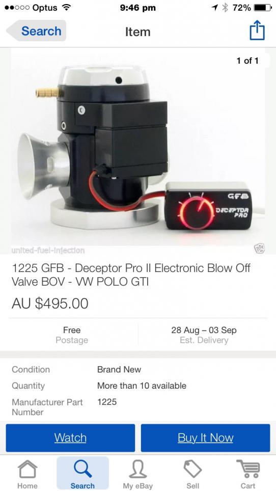

    Blow Off Valve for the new Polo GTI released
    too bad its around $500, would've been interested if it wasn't a ridiculous price right now.
    Blow Off Valve and Kit for Audi and VW 1.8 and 2.0 TSI
    Jul 2015
    Bendigo, Victoria
    25
    Does anyone know if this blow off valve is suitable
    Would love the adjustable option
    Jun 2008
    Ringwood, Victoria
    4,140
    Blow off valves are not a good idea on these cars that have a diverter valve, there are many many threads about them and why they adversely affect performance etc.
    If you're after the "pssstch" noise then maybe a supra or 200sx would have been a better choice... in all seriousness though, for the sake of a sound that leaves most people shaking their heads at you as you drive past, would you really spend $500 to make the performance of your car WORSE and more unreliable....?
