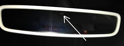

    Awesome, thanks for the photo. The rear sensor on mine is near the top-centre of the glass. I'll have to check next time I'm out at night but I think they've made an error by moving it to the top.

    I see on the 'net a number of reports of this feature not working well when you have tinted windows or factory "privacy glass." My Polo has this as a standard feature on the rear and rear-side windows.
    There must be new Polo owners out there with this newer model mirror? It may not be a Gentex like the one in DV52's photo above, as I can't find this one on their web site.
    If this continues to be a problem for me I'm perfectly willing to disassemble the mirror and see if I can modify the electronics to bias the darkening further.

    My suggestion is that you first try the "low tech" solution by placing multiple pieces of translucent sticky tape over the front sensor. If placing your finger over the front sensor doesn't make the mirror dim to its max level, then I suspect that you have other problems. If the mirror does dim, then it's just a matter of finding the correct amount of translucent material to cover the front sensor. Yes, I agree that it's not as sexy as the "pull-the-mirror-apart-and-figure-out-an -electronic-solution method, but it's an easy first try method IMO.

    ... If placing your finger over the front sensor doesn't make the mirror dim to its max level, then I suspect that you have other problems. If the mirror does dim, then it's just a matter of finding the correct amount of translucent material to cover the front sensor. ...
    Yeah, it's plenty dark at night here and I think it's not an issue with the front sensor, more that the incident light from cars following some distance behind is not sufficient to dim the mirror much after being attenuated by the rear window tint.
    I need to get more experience with it before I decide what to do.
