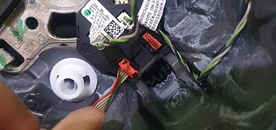

    Remove the ribbon cables from the MF controls and the control unit
    Steering Wheel Upgrade/Conversion with Functional Controls-20220815_133149-jpg
    Steering Wheel Upgrade/Conversion with Functional Controls-20220815_133404-jpg

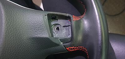

    Unfortunately, I can't seem to find any OE part numbers for the blanking plate that goes on non-DSG GTi's
    Steering Wheel Upgrade/Conversion with Functional Controls-20220815_161707-jpg
    Will be using resin clay to fill in the paddle shifter switch without the paddle actually attached.
    Will post an update when I've filled in the hole and the wireless switches come in the mail.
