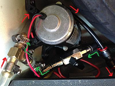

So the pump is a $28 "Singflow" ebay shurflo rip off. Its a diaphragm pump 5L/min, 100psi and 4.5A rated current. It has viton seals so its meth friendly but I'm just running water. The main thing is to get the highest pressure you can with the lowest flow. High flow pumps won't have the same start up punch and/or if they do they'll draw a lot more current than they are designed to when they try to pump all their flow capability through a spec.
I got this one because its metal bodied and had external pressure switch wiring. I didn't want the pump pressure drop triggered (I wanted it boost triggered) so I needed the pump to have external pressure switch wires so that I could bypass them ie I just cut the actives path through the switch and wired directly into the motor. If you don't do this, when you trigger the motor with your boost switch, the motor will start to pump but because its trying to pump through a tiny nozzle the pressure will suddenly rise switching the pump off again. But your boost switch is still telling it to run so it tries again and the same cycling will just happen over and over. The answer for this (if you buy a motor with internal pressure switch wiring that you can't get to) is to run a water bypass. Now I ended up having to run one anyway (more on that later), but it would look exactly like what I've labelled in green on the motor pic. It takes excessively jacking pressures (the kind that will switch off a pressure triggered pump) and feeds it back to the low pressure side of the pump so that the pump can run continuously. My tip - just try to buy a pump with external wiring.
As you can see the motor is mounted in the boot wheel well and is fed by the clear lines from the tank and pumps out via the pneumatic hardlines under the car, up through the guts of the driver side fender and out into the engine bay in the gap between the fender and headlight, and then directly into the solenoid.

So the 8mm hardlines bring pumped water (in red) into the solenoid. The solenoid is a quality $45 LPG fuel lock off valve. You can buy them off ebay. It had a rated working max pressure of 100psi (which I thought would be ok) and I chose it because its designed to lock off liquids and is also meth safe if I choose to run meth down the track. The solenoid controlled water leaves in blue, coils around a bit and then feeds through an industrial high pressure filter in the next pic. Filtered water exits in 4mm hardline into the nozzle.
The solenoid is wired in parallel with the pump so that they will come on simultaneously. But a problem I soon discovered was that you would hear the control relay click, the pump start but the actual nozzle wouldn't fire until up to a half second delay. In half a second I reckon my turbo can just about double boost so that wasn't going to cut it. What I found, was that basically the solenoid piston was being overcome by pumped backpressure. The first test fire was perfect - the second test fire was delayed. When the solenoid plunger dropped to cut flow the pumped pressure behind it would spike perhaps due to pump run on but also due to the flex in the pumps diaphrams. Then when you went to trigger the pump/solenoid again the solenoids plunger was struggling to retract as the water pressure was torqueing it laterally. I found this by disconnecting the pump and when I triggered just the solenoid it would control the water perfectly.
The ideal solution is to just get a proprietry water/meth injection solenoid but $$$ and the fact that I'm running out of time before an upcoming hillclimb made me just go for the pressure bypass method that I mentioned in posts above. I ran the pump till I knew the solenoid was bound, then cracked the bypass until I saw the hoses suddenly relax. That way I knew any residual pressure couldn't build behind the solenoid when the solenoid turned off. Nozzle works perfectly now with no perceptible change in spray start up and the pump will no doubt be less stressed. Like I said this was just a way around a slightly over powered solenoid. If you have a proprietry solenoid eg some are rated up to 300psi or are pumping at lower pressures eg 80psi pumps are common, then this will not be an issue.

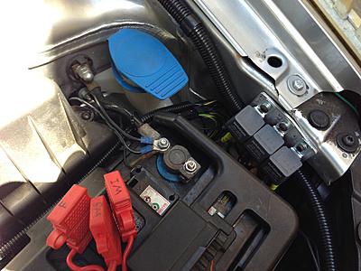

The other pic just show my relay bank - intercooler water spray, water injection and intercooler fan. And the other shows the manifold that I've fitted to mount my boost pressure switches. The far one is for the water spray. It turns on at 14psi and off at 12psi. The closer of the two is the water injection boost trigger. I'm still experimenting with the best switch on point but aquamists recommendation to set it at or just below the max standard boost level that it had from factory seems to be close to best. ie if VAG engineers thought it safe below 11psi then I'm taking care of all the temps and cylinder pressure that I've added beyond that.
