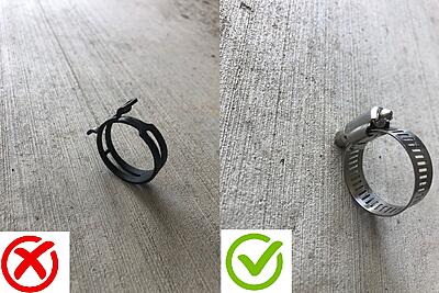

    I also (where access was possible) replaced the hose fittings with screw fit hose clamps (Jubilee clips). The VW hose clamps are a massive pain in the arse to remove without the special VW tool which is too expensive and unnecessary. I would recommend this as the replacement clamps are cheaper than the special tool, easier to work with and in my experience, make for a more reliable seal.
    The Notorious 1.4 CAVD twin charge... a story-clamp-jpg
    eBay sells the (cheap) tool needed to work with these hose clamps
    You can also use angled pliers
    These clamps are used on a all euro cars and are not a failure item
    These clamps normally have a tag that holds them in the open position making re-installation very quick and easy
