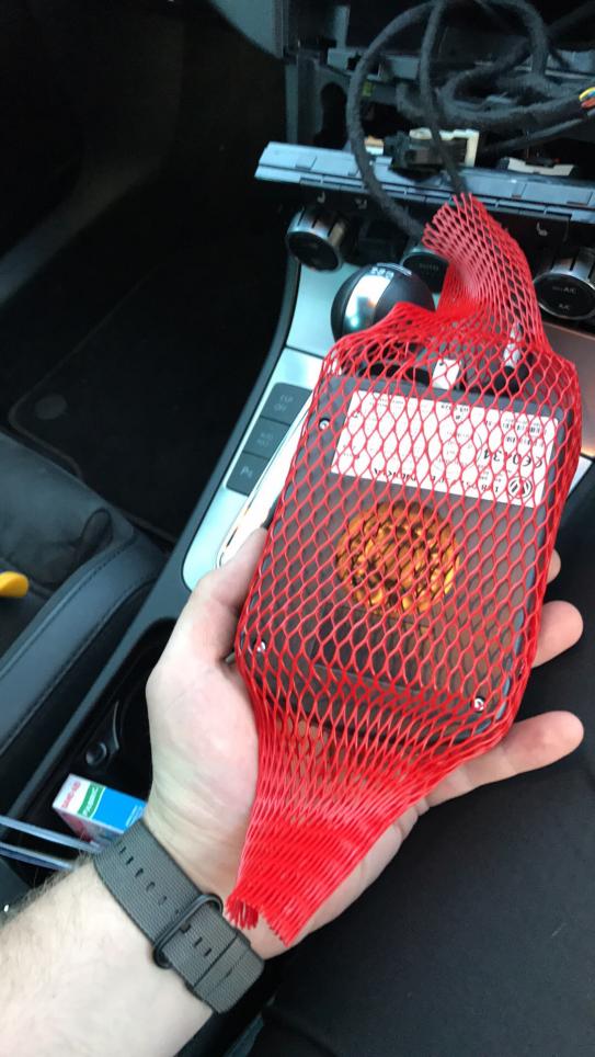

Bluetooth Upgrade Time!
Long overdue upgrade to the dealer fitter NOKIA bluetooth kit in the 36.
Removing the old module was a pain in the ass seeing as it was behind the head unit (tucked up under the dash) rather than the factory fitted under the seat option. This kit was a straight swap and because it's a 9zz kit, I keep all functions and all steering wheel buttons (even the phone button that almost always goes with a standard 9w7 kit)
NOKIA kit gave me:
- Stereo bluetooth streaming (head unit only said "BT-Audio") and i had no controls through head unit or MFD.
- Phone button worked on the steering wheel to answer/decline calls.
- No details shown on the RNS510 in regards to calls.
- PHONE button on head unit acted as a MUTE button due to lack of Premium BT module.

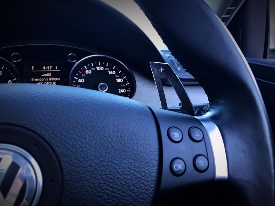

Premium Kit gives me:
- PHONE screen/options on MFD display.
- PHONE screen/phonebook/prompts on RNS510 head unit.
- Full control over music through head unit and MFD (skipping tracks/volume etc).
- Full music details on MFD and RNS510 (track/artist/album/track duration etc.)
- Bluetooth music automatically starts on vehicle start-up.
http://www.vwwatercooled.com.au/foru...574bf5a3-1.jpg
*This is the old NOKIA module*

*PHONE menu on MFD screen*
