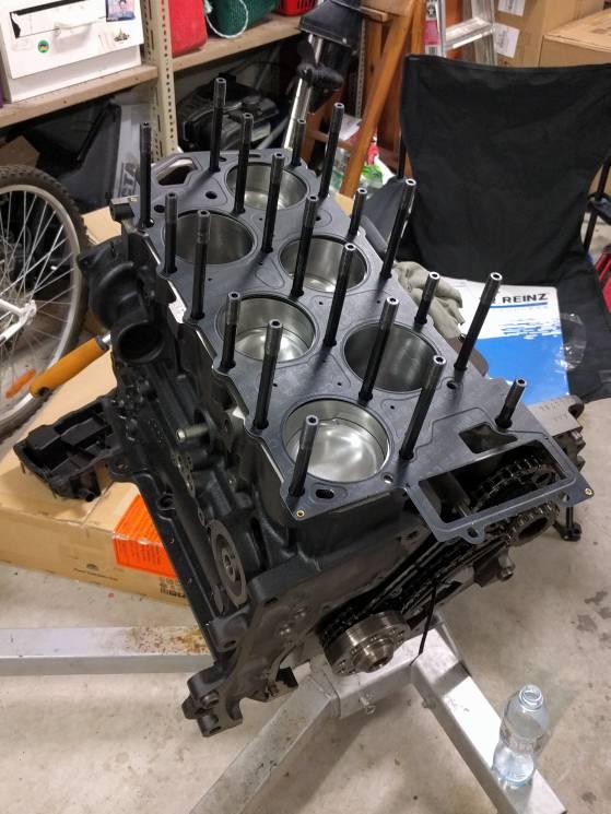

Lower timing chains are on now and I've put a new metal head gasket and torqued down the head to spec. Not long now I just need to set the timing, bolt on accessories and cover plates and it'll be time to put her back in.

Noice. Did the gasket going prompt the angry rebuild?
Thanks guys!
The gasket wasn't the cause it was one of the pistons cracking, I guess cast pistons and rods can only take a certain amount of load!
