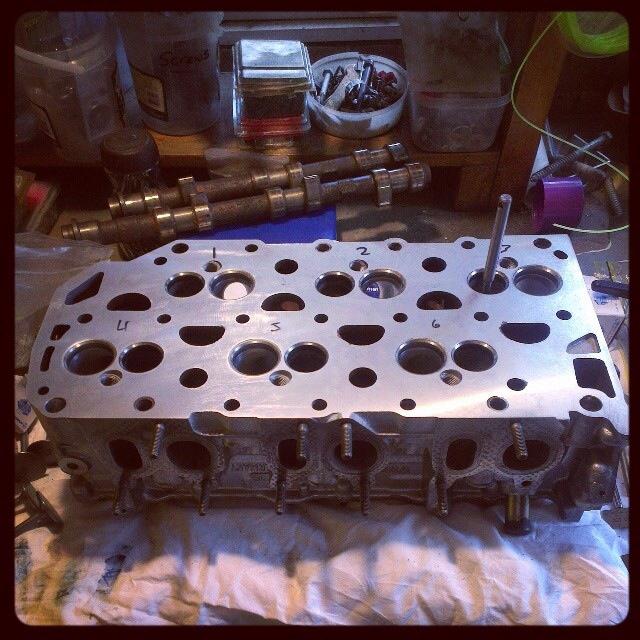

One for mk3 aaa, seats cut and cleaned up, 60deg cut also done.
Tomorrow will do a 20deg (think that's what it was) and reassemble

30 deg cut done, valves lapped in. Just need to give it a clean out and reassemble now.
Thanks to Golfman for the help and lessons!

Did u do the port work at home as well ?
Haha hope your machinist is having fun clearing that block.
Didnt do any port work. just cleaning, deck, new guides and seals, multi angle valve job.
Cleaned out the block manually with lots of poking, pulling, flushing, magnetic tools.
