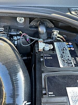

    On Stop-Start ....
    On the facelifted T-Rocs the Aliexpress dongles no longer works as the plugs behind the buttons have changed.
    You can however unplug the battery monitor plug on the battery which disables stop-start completely. An error message will appear briefly once per drive in the center of the instrument cluster. No other warning lights.
    Considering a TROC R or a TROC R LINE-t-roc-ss-disable-1-jpg
    Considering a TROC R or a TROC R LINE-t-roc-ss-disable-2-jpg
    Considering a TROC R or a TROC R LINE-t-roc-ss-disable-3-jpg
    Alternatively, you can install the OEM+ tune from Racingline (arguably the best out of the box tune available)as it sets stop-start to off as the default. Button retains full functionality if you want to enable it after starting the car.
